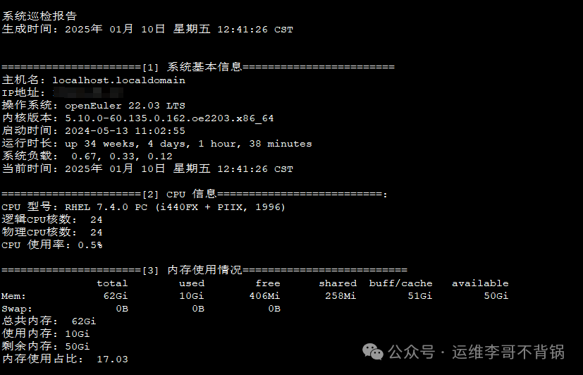

log"======================[1] 系统基本信息========================"
log"主机名: $(hostname)"
log"IP地址: $(hostname -I | cut -d' ' -f1)"
log"操作系统: $(cat /etc/os-release | grep PRETTY_NAME | cut -d= -f2 | tr -d '\"')"
log"内核版本: $(uname -r)"
log"启动时间: $(uptime -s)"
log"运行时长: $(uptime -p)"
log"系统负载: $(uptime | awk -F'load average:' '{print $2}')"
log"当前时间: $(date)"
log""
log"======================[2] CPU 信息==========================:"
log"CPU 型号: $(lscpu | grep 'Model name' | awk -F: '{print $2}' | sed 's/^ *//')"
log"逻辑CPU核数:  $(grep "processor" /proc/cpuinfo|sort -u|wc -l)"
log"物理CPU核数:  $(grep "physical id" /proc/cpuinfo |sort -u|wc -l)"
log"CPU 使用率: $(top -bn1 | grep '%Cpu' | awk '{print $2}')%"
log""
log"======================[3] 内存使用情况=========================="
free -h | tee -a $LOG_FILE
log"总共内存:  $(free -mh|awk "NR==2"|awk '{print $2}')"
log"使用内存: $(free -mh|awk "NR==2"|awk '{print $3}')"
log"剩余内存: $(free -mh|awk "NR==2"|awk '{print $7}')"
log"内存使用占比:  $(free | grep -i mem |awk '{print $6/$2*100}'|cut -c1-5)"

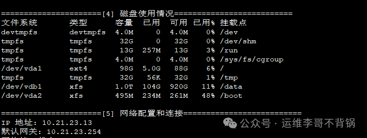

log"======================[4] 磁盘使用情况=========================="
df -hT | tee -a $LOG_FILE
log""
log"======================[5] 网络配置和连接=========================="
log"IP 地址: $(hostname -I)"
log"默认网关: $(ip route | grep default | awk '{print $3}')"
log"网络接口状态:"
ifconfig  | tee -a $LOG_FILE

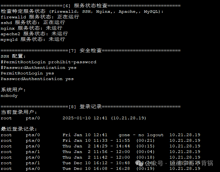

log"======================[6] 服务状态检查=========================="
log"检查特定服务状态 (Firewalld,SSH,Nginx,,Apache,,MySQL):"
for service in firewalld sshd nginx apache2 mysqld; do
    if systemctl is-active --quiet $service; then
        log"$service 服务状态: 正在运行"
    else
        log"$service 服务状态: 未运行"
    fi
done
log""
log"========================[7] 安全检查============================"
log"SSH 配置:"
grep -E "^#?PermitRootLogin|^#?PasswordAuthentication" /etc/ssh/sshd_config | tee -a $LOG_FILE
log""
log"系统用户:"
awk -F: '{if ($3 >= 1000) print $1}' /etc/passwd | tee -a $LOG_FILE
log""
log"========================[8] 登录记录============================"
log"当前登录用户:"
who | tee -a $LOG_FILE
log""
log"最近登录记录:"
last -a | head -10 | tee -a $LOG_FILE

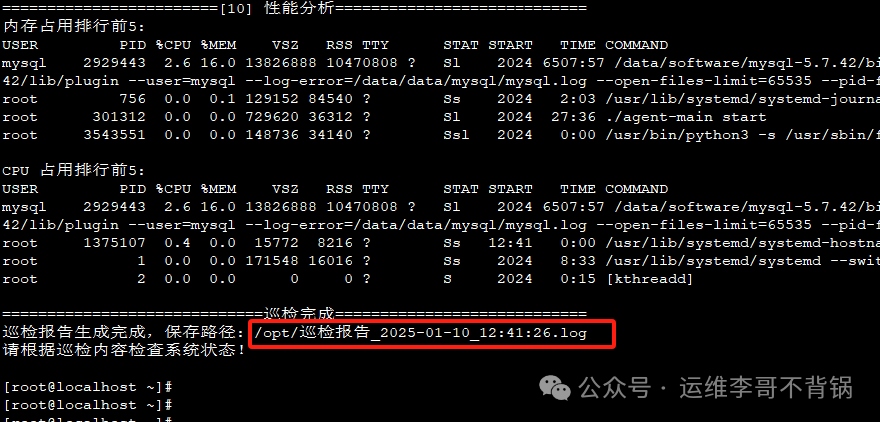

log"========================[10] 性能分析============================"
log"内存占用排行前5:"
ps aux --sort=-%mem | head -6 | tee -a $LOG_FILE
log""
log"CPU 占用排行前5:"
ps aux --sort=-%cpu | head -6 | tee -a $LOG_FILE
log""
log"=============================巡检完成============================"
log"巡检报告生成完成,保存路径: $LOG_FILE"
log"请根据巡检内容检查系统状态!"
