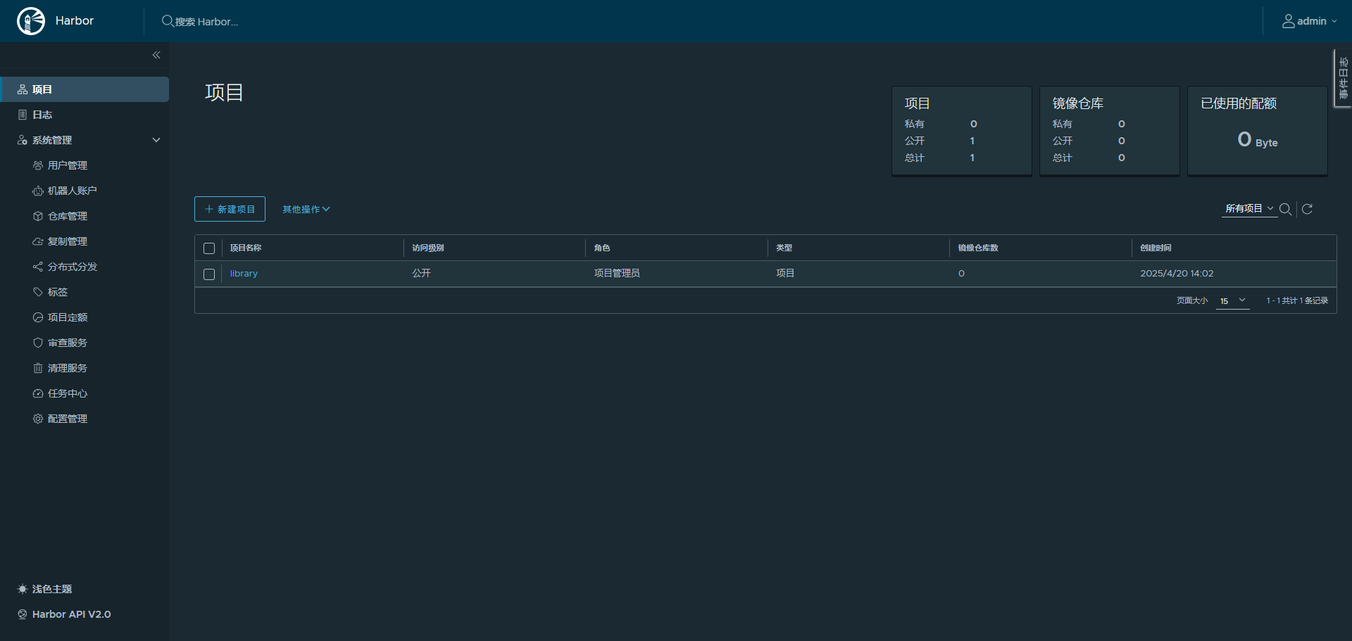

http://10.0.0.10:80/
或者使用你配置好的域名访问也可以

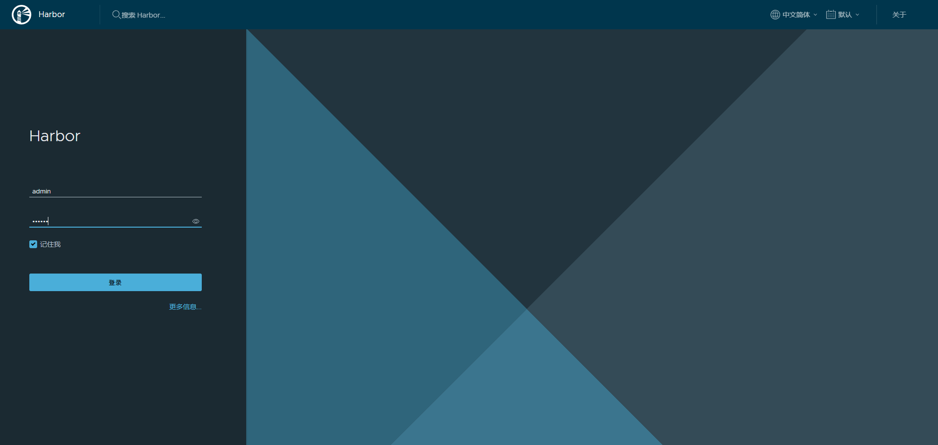

登录harbor:
用户名:admin
密码:前面我们配置的,123456

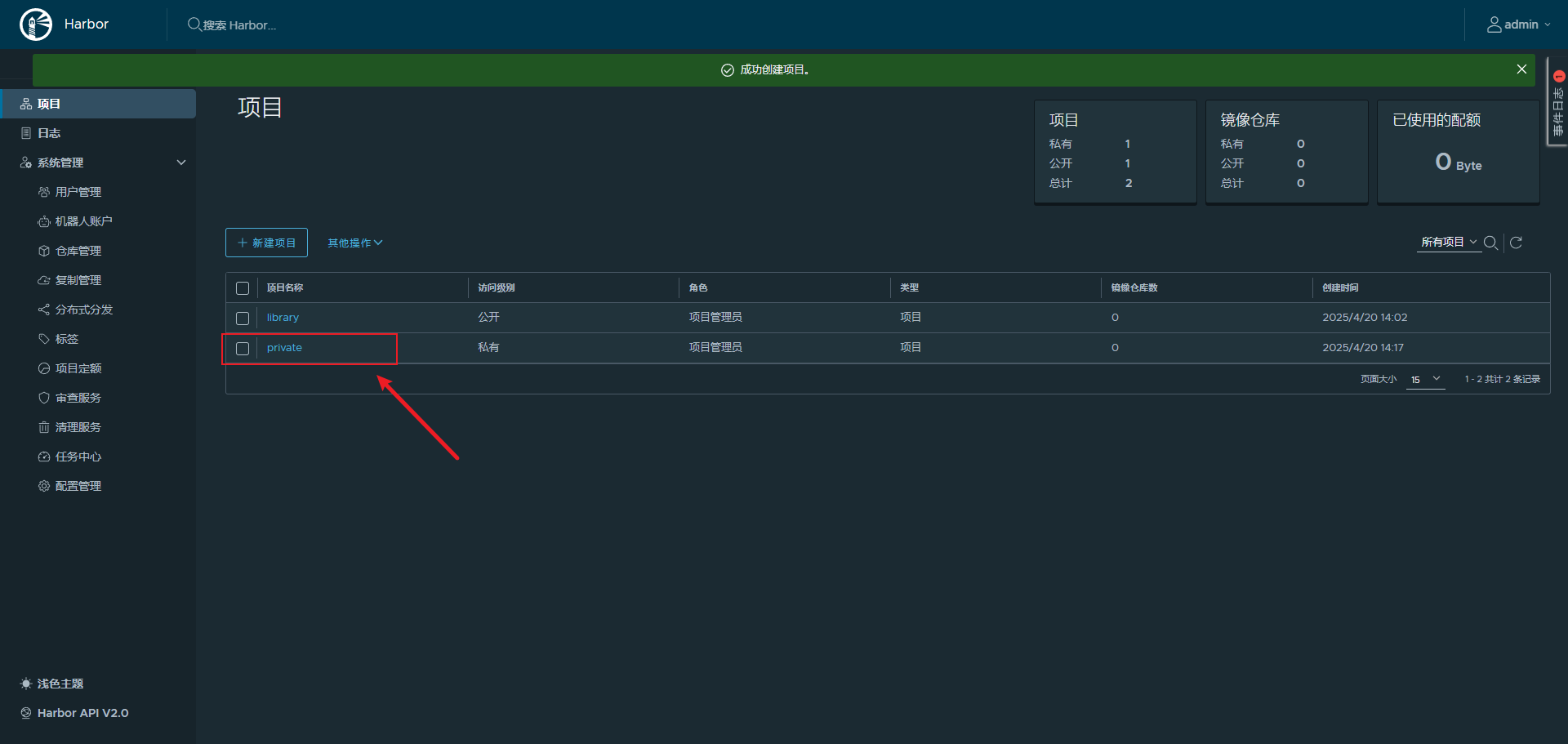

在harbor仓库新建一个项目
推送镜像

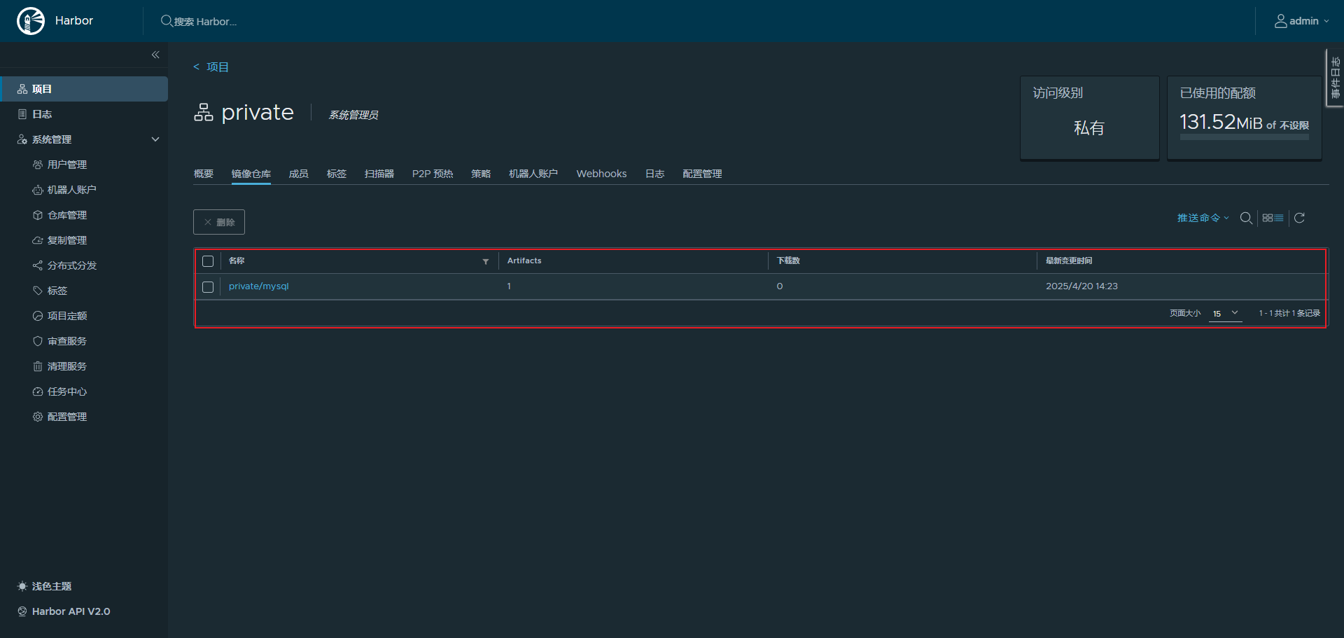

# 打标签[root@lb ~/harbor]# docker tag mysql:5.7 reg.huangsir.com/private/mysql:5.7# 推送镜像[root@lb ~/harbor]# docker push reg.huangsir.com/private/mysql:5.7The push refers to repository [reg.huangsir.com/private/mysql]441e16cac4fe: Mounted from library/mysql73cb62467b8f: Mounted from library/mysql337ec6bae222: Pushed532b66f4569d: Mounted from library/mysql0d9e9a9ce9e4: Pushed4555572a6bb2: Pushed8527ccd6bd85: Pushedd76a5f910f6b: Pushed8b2952eb02aa: Pushed7ff7abf4911b: Pushedcff044e18624: Pushed5.7: digest: sha256:4b6c4935195233bc10b617df3cc725a9ddd5a7f10351a7bf573bea0b5ded7649 size: 2618通过浏览器查看,发现我们的镜像已经推送成功了

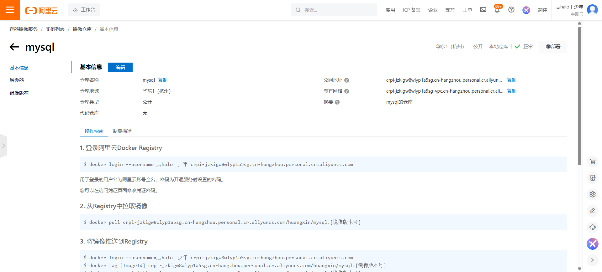

登录到阿里云镜像仓库
点击访问凭证即可,我们可以设置固定密码,后续登录就使用改密码进行登录
[root@lb ~/harbor]# docker login --username=灬halo丨少年 crpi-jzkigw8wlyp1a5sg.cn-hangzhou.personal.cr.aliyuncs.comi Info → A Personal Access Token (PAT) can be used instead.         To create a PAT, visit https://app.docker.com/settingsPassword:WARNING! Your credentials are stored unencrypted in '/root/.docker/config.json'.Configure a credential helper to remove this warning. Seehttps://docs.docker.com/go/credential-store/Login Succeeded新建命名空间和镜像仓库

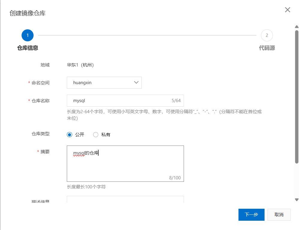

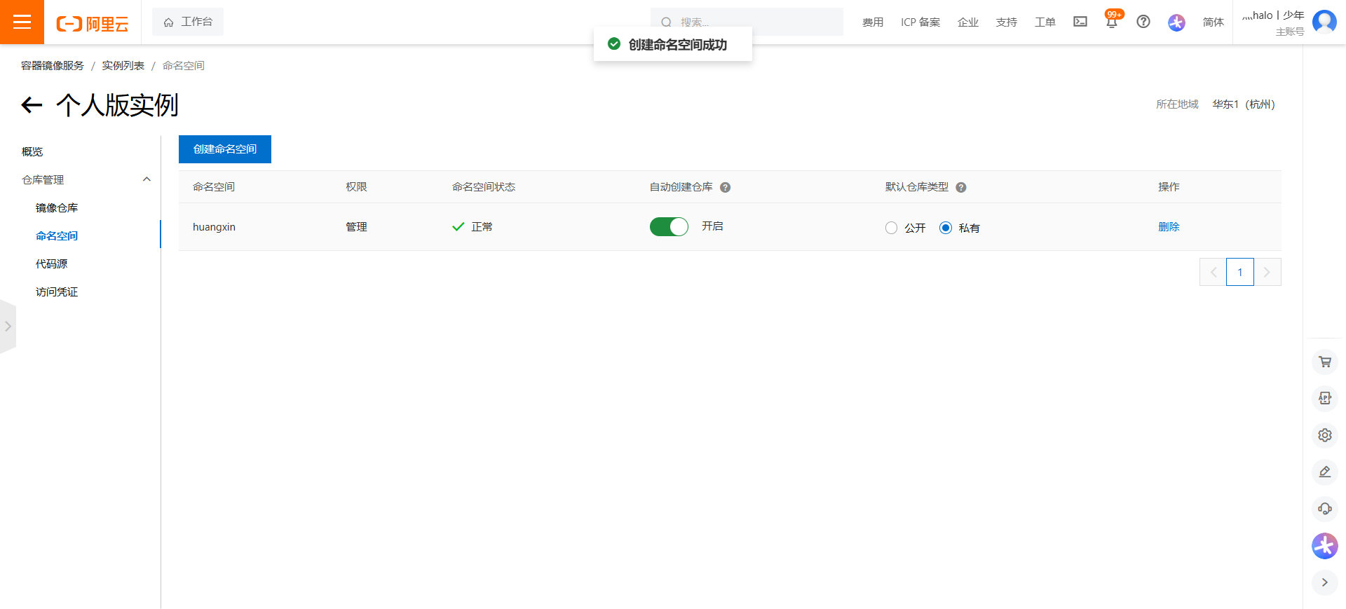

新建命名空间

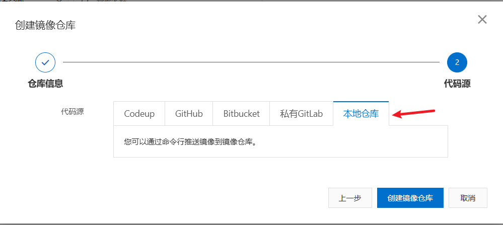

新建镜像仓库
选择本地仓库
duang,我们的镜像仓库就建好了
